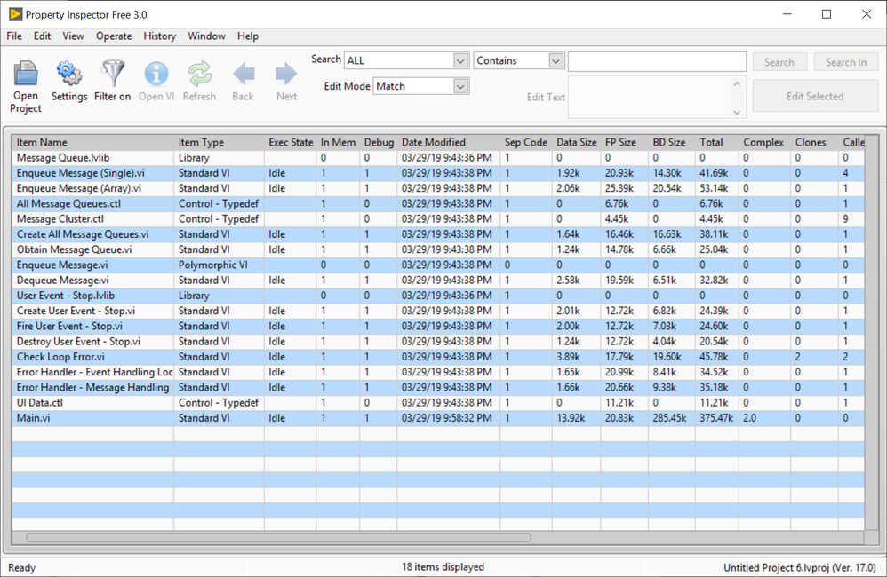

There is a free utility on the LVTN that will display Compiled Code Complexity for all the VIs in the project as well as 41 other properties in a single window.  Here is your project as it is displayed. You might find it interesting to examine your full project.  Click the Complex title to sort the project by CCC.
