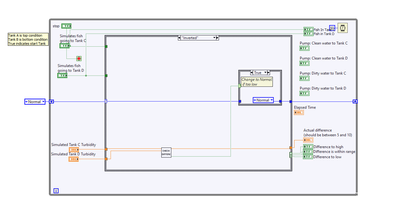

I got you started with something that might be less overwhelming than what you had.  I added one subvi using your pre-existing function as an example. You will have to convert the rest over  (I reccomend using subvi for your functions so that they can be used repeatedly, and to make it more easy to read)  Let us know if you are able to complete the project

Thank you so much, that seems to work.
