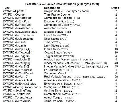

If you have some experience with this, would you be able to give me some direction and how I go about converting the Variant the is returned from the FastStatus call.  The manual shows me what the packet looks like (the 280 bytes is wrong, it is actual 284 bytes).  See below:

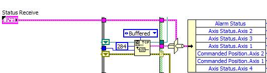

As I mentioned, I gave up on the Com6Srvr, and decided to use the direct ethernet mode instead. However, I'm guessing that the FastStatus data is similar or identical to the raw status data received directly over ethernet, since the descriptions look similar. The trick is to get the variant into some usable form first. You'll need to use Variant to Data. I would first try using, as a type input, a cluster similar to the "Status Packet" type definition attached here. You might even be able to use that cluster directly, although your screenshot from the manual shows a few more fields at the end. Also wire the error out of Variant to Data so you can easily see if there's an error. If that doesn't work, try wiring a string constant as the type input, then typecast to the cluster (as shown in the image below). If that doesn't work too, try an array of U8 as the type input and typecast that. If that still doesn't work, attach your code and post the error description.

Thanks for the suggestions.  In the end I ended up type casting the variant to a U8 array and indexed through the array to convert the various parts to I32 and Double (VAR are doubles).
Terry.
