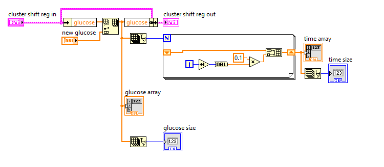

I did, and unfortunately it didn't work. I've attached a VI that should have the values included with it, for you to look at. It's very much a work in progress, so excuses the willy nilly indicators and lack of comments
edit: I seem to be unable to post the VI at the moment. Here's a picture, as my snippet was too large:Capture.PNG

What does this code have to do with xy graphs?
Don't you want to initialize the shift regisiter? (Else the time array will grow without bounds. Shouldn't it be the same size as the glucose array?) In fact you don't need a shift register. A plain autoindexing output tunel would suffice.
Why do you use "insert into array" instead of "built array (concatenate mode)".
Since your time array points are spaced equally, you don't need an xy graph. a plain graph is suffiient. Just set x0 and dx according to your data.

This is just a subVI that would output a graph for use in the main VI. I use insert because the concatenate makes a 2d array, whereas glucose needs to be a 1d array. What kind of graph? Waveform? something else?

If you right-click "build array", you can select concatenate mode.

Yes a waveform graoph. Set x0=0, dx=0.1.

When you wire two different kinds of arrays together (different dimensions), the concatenate is already selected. However, I managed to use pre-existing logging to make the graphs. There's going to be extra disk reads, but it worked immediately, without any of the weirdness that was going on before.
