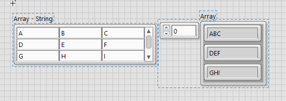

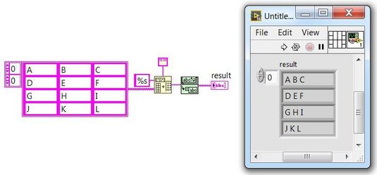

As shown below, I am trying to find a fast and efficient way to concatenate strings across all rows, in a 2D array, into a 1D array. The example below would normally be sufficient; however, I DO NOT want a delimiter. Notice how in this example, even though I specify a blank string for my delimiter, the function still inserts a space! I may be dealing with large data sets that require concatenation in this fashion, so I would like to iterate as LITTLE as possible in LabVIEW. I may be overlooking something obvious, if so please point it out! There may be a toolkit that includes a function that does this fast and efficiently, if so please let me know! Thanks all!

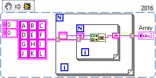

... or if you don't know about that "magic function" that McDuff used, you can always use For loops (the Snippet is LV 2016, but should work with almost every version):

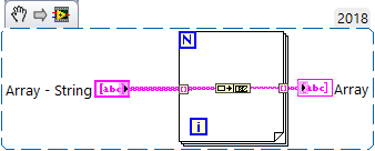

That "magic" function is the same one you used, Smiley Tongue, I just removed one of its terminals. The function is Concatenate Strings, on the string palette. It will concatenate a string array to a single string. And there is a single For loop in my snippet.
mcduff

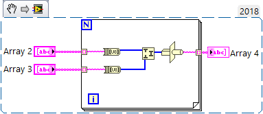

What you are asking for in your last response is different from the original question. Below is how to "Add" two 1d string arrays of the same size, however, it needs iteration, and type cast ALWAYS makes a data copy. 😞
Strings are always going to be memory hogs in LabVIEW, especially if they are being resized constantly.

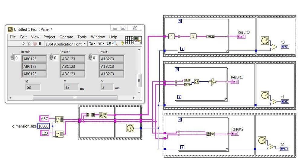

Actually, the intent is still very much the same. Please see image below. Also, why would you want to cast that data? If your iterating anyways, why not just concatenate? see comparisons below. Thanks!
EDIT, made a label mistake, just updated photo sorry. Also, the type casting method seems to interleave the text, not what I was intending. But thanks!
Message 8 of 17
(5,142 Views)
I was trying not to use loops with those methods, I was starting to use reshape arrays, string to bytes, etc, and then had to do work that pays. Pass it along to the Rube-Goldberg thread. Smiley Happy

PS Your timing comparison is not good, run each method without any others. Yes LabVIEW can do tasks in parallel, but you cannot predict the order.
mcduff
