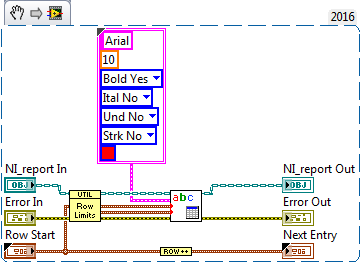

Well, I tend to do as much with RGT and as little with ActiveX as possible.  Here's my "Red One Row" (as opposed to another VI, Read One Row) that turns the selective text in the row Red (you can guess what Black One Row looks like).
[Confession -- the function "Row Limits", I'm embarrassed to admit, does use ActiveX -- it looks at the UsedRange property of the Worksheet, gets Columns, and sets Row Start's Column to Count-1, the last Column.  However, Next Row is "pure", mostly ...].

You are correct on both observations.  I did not attach Row Limits, rather I told you what it was (ActiveX, and I specified all the steps).  And yes, I specify the entire WorkSheet, but the function I was using to apply the Format specifies the beginning and ending Cell.  My function "Red One Row" turns one row Red by specifying the first Cell of the row, uses Row Limits to get the last Cell of the row, so together they specify the beginning and ending Cell, just what the Excel Set Cell Font function requires.  Did you read the Help for this function?
