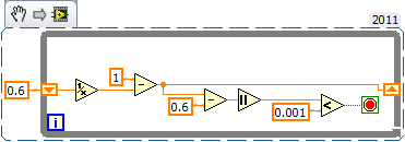

This is what I did until now.

Hi Aeros,
and what was the problem with your VI?
Message 5 of 15
(5,644 Views)
It seems that it does not go back and update as I intend. The thing that I am trying to do is in the attachment.
Message 6 of 15
(5,638 Views)
Hi Aeros,
You wired the "C_calculated" into the shift register, so it will be used in the next iteration (like in your requirement).
As I don't have your DAQ hardware you need to debug your VI with real values on your own.
Is the iteration condition met?
Btw. I miss the root(1-beta^4) term in your VI…
Message 7 of 15
(5,634 Views)
Since beta is a constant value, I directly wrote constant value to the vi instead of root(1-beta^4).
Condition did not met but I guess there is a problem with calculation. Unfortunately, I can check that tomorrow because I left the lab. Thank you very much for the help.

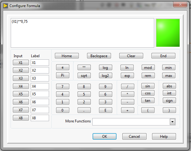

I don't know if this is a problem, but can the Formula Express VI handle a "," as the decimal point?
The formula is (X1)**0,75 and when I run it, it ALWAYS returns "1". It appears to ignore everything after the "," so for me, it evaluates (X1)**0
Why not just use the native LV exponential function Power of X? Seems much simpler than hiding the formula in an express VI.
