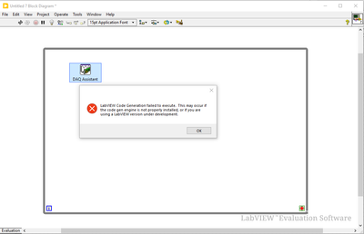

The error is pretty self explanatory, there's a problem with your installation.
Open Package manager and make sure you have everything you need.

This may be a known issue.
Refer to the discussions at https://forums.ni.com/t5/LabVIEW/Fix-LabVIEW-Code-generation-failed-to-execute/td-p/2286724
If you use NI DAQmx 2022 Q3, then it is a known issue documented here - https://www.ni.com/en-in/support/documentation/bugs/22/ni-daqmx-2022-q3-known-issues.html
