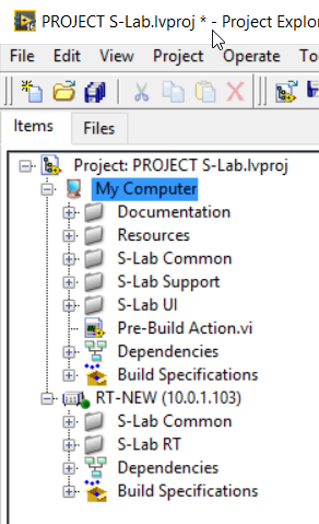

It seems, to me, that this card is designed for a PXI Chassis with an appropriate Controller running some version of LabVIEW's Real-Time Operating System.  You need to have the Real-Time Module installed on your Development PC.  With this, you can create a LabVIEW Project that has two targets -- a PC ("My Computer") that runs the User Interface and communicates with the PXI Chassis, and the Remote LabVIEW RT system that runs on the PXI Chassis and contains the PXI DAQmx hardware.  Here's a picture of such a LabVIEW RT Project:
All of the LabVIEW code is managed by the LabVIEW Development System on the PC, but the PXI code is designed to be deployed (and run) on the remote RT Chassis.  Note in the illustrated Project this is the device called RT-NEW, which is connected to the PC via TCP/IP, in this case with an IP of 10.0.1.103.
