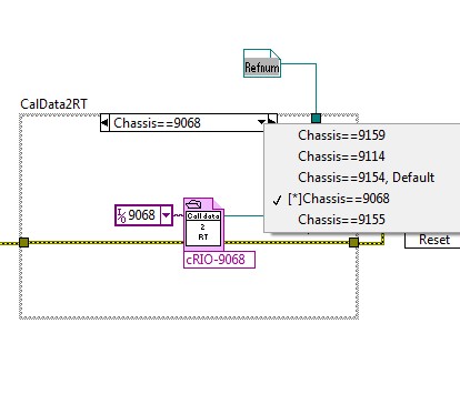

I suggest to use Conditional Disable Symbols on the project level. My example shows the selection of a bitfile by the created symbol 'Chassis'. For the resource names I use aliases set in the MAX on device (RIO0) level.
Hope it helps
Christian

christian_w,
Thank you for your suggestion. It works quite well, and I no longer have the insufficient memory issue. However, there is unexpected behavior. If I first do a build of each of the FPGA VIs, and then change the value of the Conditional Disable in the Project to switch between which FPGA code is used, then I am required to re-build that particular FPGA code. It seems quite odd, and I don't understand it. Do you (or anyone else out there) have any thoughts on why this might occur?
