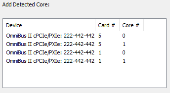

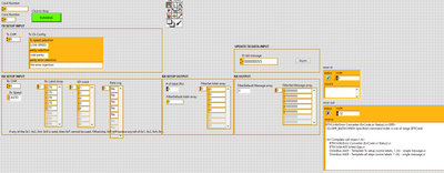

I am doing a single channel configuration of a simple example file from online but I can't seem to be able to figure it out. Can someone guide me to the right places. I tried it for a week and couldn't figure out the errors.
This is what I know.
I tried changing TX ch# to 8, 16, 24 and still errors.
Maybe the sample don't work? Maybe the DLL/Library is bad?

Core 0  Rx (CH0-CH07) Tx(CH16-23)
Core 1  Rx (CH8-CH15) Tx(CH24-31)
So in your example you are talking to you highlighted in Red Rx & Tx channel that are on different Cores but only initialized one Core and talked to one Core, that I believe is why you are getting the error you are seeing, talking to an un initialized Core.
Make life easy to start and try to message Tx Core 0 CH 16 to Rx Core 0 CH6 both on the same Core.
