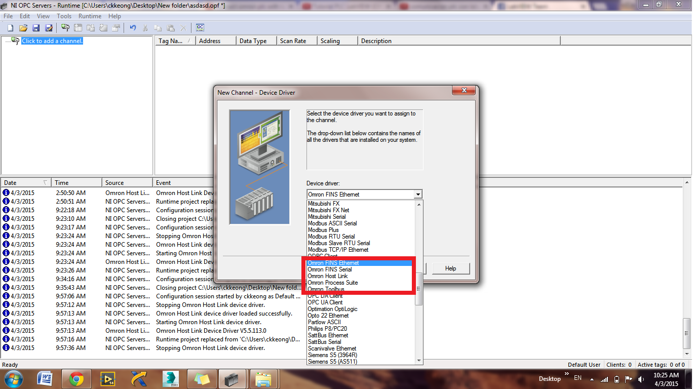

Hi Labview experts! I need help on integrating Labview with Omron PLC CP1L using USB connection. When adding a new channel, which of the device driver I should choose for USB connection? And how to link the tag to I/O in cx-programmer? It would be perfect if anyone can guide me through the whole process. Sorry if my questions sounds stupid as I am really new to these.

I'd try the serial as USB is a form of serial connection

You can find your device at list of server help ,that includes all devices.You have to look all titel,what related to Omron.
I look short but i cant find CP1L model PLC of Omron.
I guess that  you can choose the FINS ETHERNET and connect with Ethernet.
