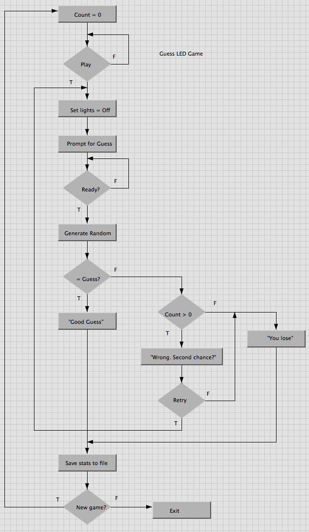

You really need to put together a design for your program. The last piece of code you posted can freeze up under many combinations of button presses forcing an abort to end the program.
It still provides no feedback to the user.
It does not accurately display the results.
With 5 booleans to guess the probability of a correct guess is very low. This will frustrate players unless the rewards for a correct guess are very large.
The image below is a simplified starting point for a design.  A comprehensive design may require several of the boxes to be expanded into much more detail. For example Prompt for Guess includes displaying a prompt message (I would not use a dialog box, but that may be one of your requirements), setting the LED Display to blinking, and starting the timer. The flow chart shown does not include any provision for stopping the program. It does not handle errors (what happens if the Arduino gets unplugged while the program is running?). It does not show any of the timing, mostly because I have no idea of what you want the timing to do.
After you get a complete design document, then you begin to implement it in your program.
Lynn

thanks this is help. I want to timing to give the users 10-15 seconds to make there guesses. Do you have time where we can work through this piece by piece step by step?
