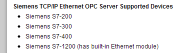

Dear Carmen,
Thanks for the answer. I want to clarify if NI OPC does or does not support my PLC model?
Becuase there is only S7-200 in NI OPC Server.
(6,427 Views)
Hi Gevorg,
It does:
(6,413 Views)
