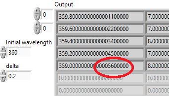

The problem occurs only when it's needed to compare the value contained in "wavelength to" indicator with the preset one. If you try to create a double numeric control and write there, for instance, 359, it will not be equal to 359 in the indicator. That was the original problem.
It will be very, very close, but as has been mentioned several times, equal comparisons with floating point numbers are often invalid due to their nature. For example 0.1 cannot be represented in binary with a finite number of bits.
Here's how it looks when you show more decimal digits:
