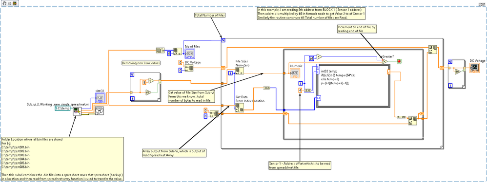

To solve above problem I have created following algorithm.
Please note , my algorithm works but , I get memory full error (sometimes ) and some data of sensors is missing , may be becasue there might any limitation to what a spreadsheet file can store, but I am not sure.
Step -1  ( Reading binary files in a loop and creating a single spreadsheet file)
sub_vi_2_Working_new_single_spreadsheet.vi (Attached)
Step-2 ( Reading sensor values which are stored at different offset)
Snippet and VI file both are attached.I have put comments for ease understanding,as I might be making things complex.
Support Requested
My question , is how can i improve the algorithm.
1) I am in doubt , whether I am doing things in a correct way.
2) Because there are 64 values , there will be 64 different algortihms (which is shown in Algorithms node), My purpose is to create a GUI , so that user can select/change the formula and see the corresponding graph.
3) As the .bin files are large 400 mB , I  sometimes get memory full error, which may also be due to problem in subvi , where I am opening the same file Data.bin to store concatenated output of .bin files , but I am not too sure about it.

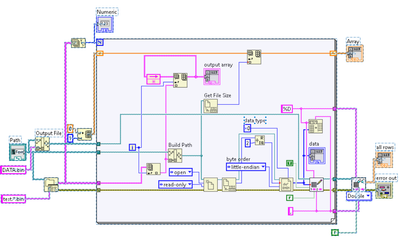

Your code is unbelievably inefficient and convoluted.
So you are reading a U16 binary file, the appending it to a formatted file, the reading the final file as DBL (4x more bytes!!!). So much hot air!!!

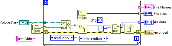

All you need is e.g. something as follows for your subVI:
(Now I'll focus on the toplevel VI. Seem highly convoluted too.....

Some questions:
Are all bin files of the same size? If not, you cannot put them into a 2D array, because all shorter rows will get padded with zeroes.
You probably want to read the file right in the main loop and process each row according to the size.
What do you want at the end? (e.g. a 2D array with 64 rows, one for each sensor)

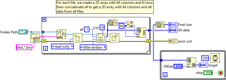

Making some very wild guesses, see if this can give you some ideas.
  • It reads all bin files in the given folder.
  • For each bin file, the flat U16 binary data gets reshaped into an array of 64 columns (And a sufficient number of rows to contain all data!) and appended to the previous data using a concatenating tunnel.
  • At the end, we have a 2D array with 64 columns, each representing one sensor. Each row is the concatenated sensor data from all files.
  • We can pick with a control which column to graph.
Most likely, this not exactly what you want, but it should give you some ideas. 😄 Modify as needed.
Message 4 of 18
(2,524 Views)
Step-1 Completed ( and partially some of Step-2 also)
I don't know why have you written , modify as needed. 😄
The vi provided by you works perfectly fine and thanks for correcting me.
I first thought of its algorithm in C, then according planned to maked the VI, but I guess experience is the key to keep the vi as small as possible for the same task.

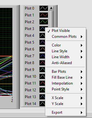

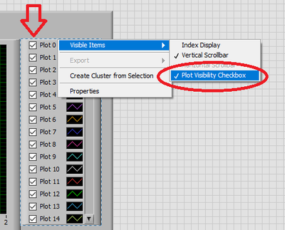

Step 3:
Would using the functionality of the plot legend be a viable solution?
Message 6 of 18
(2,483 Views)
In particular, show the "plot visibility" checkbox. No code needed. 😄
Message 7 of 18

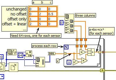

We really need to have more information on the "algorithms"
If it is just an offset, scale, quadratic, you could just apply a second order polynomial to all columns, where some of the terms might be zero (e.g. if you only want an offset for a particular sensor, the linear and quadratic terms could be zero).
Here is one possibility (It could be made more scalable, of course):
An x-shift is more tricky. You can implement a "delay" by integer multiples of dt, but shifting into the future is of course not possible 😄
Can you be a bit more specific about the exact transforms you need?
Message 8 of 18

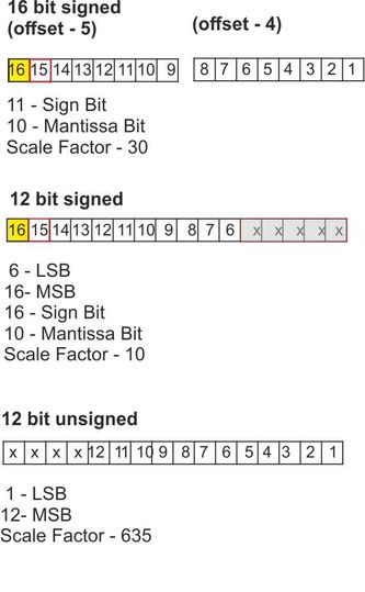

There are total 4-5 types of algorithms / parameter types.
For Eg: in 16 bit signed two 16bit values are taken from two adjacent offsets.
In higher (16-8 bits) are right shifted and then the lower 16 bits are added,after adding the result is scaled .
Like three shown above there are two more type of algorithms, which are simple, like 16 bit unsigned values and 12 bit discrete values.In total there are 6 algorithms , but the scaing factor , shift factor etc. varies.
Message 9 of 18
