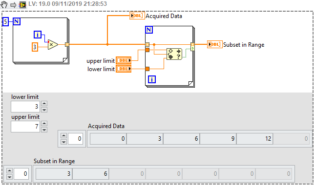

You might also consider something like this:
Here I use "In Range and Coerce" to check if the value is between some limits, then a Conditional tunnel to only output the elements where the condition is true.

Hey,
thanks for your help. A very elegant solution, but this doesn't work for me. I need data out of the range (for example: all data bigger than 5 and lower than -5). Is there also a function for it?

Currently, there is not - however, if you place a "Not" function on the boolean line between the In Range and Coerce and the tunnel, you'll get the functionality you want.
Note you can also change if the limits are included or excluded by right clicking on the In Range node.
