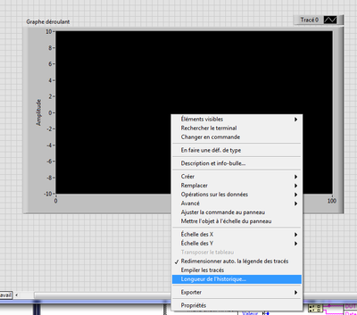

You need to change the number of point in the graph like this:
Sorry, it's in french but you'll figured out.
Just so you know, more point you save more memory it takes and ur computer will eventually crash so choose wisely.
