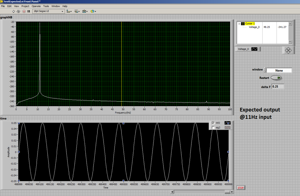

2) Attached output from trialExpected @ 11hz.
Message 5 of 32
(5,224 Views)

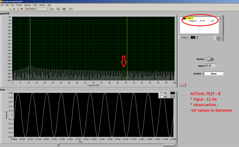

Sorry everyone for lengthy post and not asking precise question.
After studying little more, many things are clear. Even I was able to co-relate db level @11hz with signal amplitude.
My only queries remain are
(i) why output goes to -ve infinity in-case of circular buffering?
(ii) why output is not matching for both cases?
I have attached screenshots of both cases, ideal and actual.
Ideal/Expected output @11hzIdeal/Expected output @11hz
Actual output @11hzActual output @11hz
 VIs for both cases are attached in 1st post.
Message 6 of 32
(5,206 Views)

I understand that. But my query is, is my implementation of circular buffer correct? Because, results what I am getting is not matching with expected results.
Message 9 of 32
(5,162 Views)
I do not see a circular buffer in your examples, you are just enqueuing data. You need to think about how you want to implement your buffer, it is lossy, do you want to skip adding points to it if it is busy processing, etc.
There are lots of other things in your example that could be fixed, but I do not know whether you just put it together for an example.
Attached is a real hack of the program that will get it to do what you want, but I highly suggest you just look at it to see what can be done and rethink you problem.
mcduff
