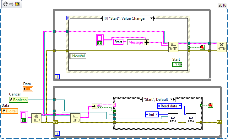

        This is the topic i want to discuss about continuous measurement using daqmx with QMH, previously i created a numerous topic on continous measurement and data logging so that i could learn more about different architectures to write a program. Now i want to discuss about the QMH architectural design patterns to draw a new idea on that, here i will start with new vi based on QMH,
with start, stop and cancel button to start and stop the measurement and to stop the vi but when i start the button i get a data values but when i press stop it was not stopping practically, i need to know what are the things i missed here and what are the things i need to keep in mind?

OK, you need to learn some Fundamentals (here presented in no particular order).
  • Keep your VI compact so you can "see everything".  Try to program with straight wires, small structures, minimal white space, don't "Show as Icons".  I used the Cleanup Tool (the "Broom") and compacted things to get this:Robinson UI.png
  • Learn how to use Value Change Events with Latch When Released switches (like Start).  You should put the Switch inside its Event (see above) so that you read it (and reset it!) when you push it (and Change it).  Data Flow!  Notice "Start" is not an Icon, is "small and compact" on the Block Diagram.

  • Using sub-VIs is often a good idea, as it encapsulates and isolates details you don't need to see right now.  However, in this simple task, it might be simpler if the lower loop actually did what you want to do, i.e. if the Init state, the Acquire State, etc. was right there.  Think about it.
  • You probably do not need to pass references into your sub-VIs.  Instead of passing a reference to the data you want to output into the sub-VI and having it pass the data out by putting it into the reference, have the sub-VI directly pass the data as an output and wire it to the data indicator directly.  Much clearer, more direct, easier to test/debug/understand.
  • Apropos the last two points, you should probably use Cancel directly, not a reference.  And it is not clear (to me) what you intend for Cancel to do.  A "State description" (in words, not code) would help.
  • Your second loop seems to be a State Machine calling a State Machine, overly confusing and tricky to debug.  Collapsing these concentric loops into one (after writing the description of what they do) will certainly simplify and may correct your code.

Adding to Bob's excellent suggestions, and referring to your msg #1 code:
1. Your DAQmx code is reading a 1D array of buffered data.  If you want buffered data you should be making a call to DAQmx Timing.vi to set during config.  You should also add an action that calls DAQmx Start explicitly.
   Or, if you only want a single sample of AI at a time, never mind the DAQmx Timing and select the 1Chan 1Samp version of DAQmx Read.  It's still a good idea to call DAQmx Start explicitly.
2. It appears you want to use "Acquire Data.vi" as an Action Engine by calling it repeatedly with different actions from your top level loop.  In that case, you shouldn't have it loop from action to action internally.  Let the calling code decide when to direct the action.
   The first thing to do is simply hardcode a TRUE to the while loop stop terminal in "Acquire Data.vi".   Then have the "Read data" action return data on an output terminal.  Also remove the delay timer.  You're not gonna loop internally any more.
3.  To retrieve data continuously now requires you to make a QMH case for "Read data" which in turn simply calls the action engine with the "Read data" action.  You need to send this message repeatedly.
   The simplest thing to do is not the best, but it can at least get you started.  Have the "Read data" message case queue up another "Read data" message for its QMH loop.  Also have the event case for "Start" queue up both a "Start" message and an initial "Read data" message.
   Here's a reason this isn't ideal: if the event loop sends a "Stop" message while the QMH loop is in the midst of reading acq data, you'll add another "Read data" message to the queue which will be *behind* the "Stop".  You'll try to read data one more time *after* stopping the task.
   There are many discussions about the dangers of a QMH that feeds messages to itself.  Be wary.

Your latest code works better after 2 simple things:
1. Your wrapper function for Dequeue should have its "VI properties" for Execution changed to be reentrant with preallocated clones.  That'll allow the loops to operate independently.  (I'd change the Enqueue wrapper too.)
2. Change the mechanical action for your GUI buttons to "latch when released".  Right click on each button to bring up the submenu.
-Kevin P
