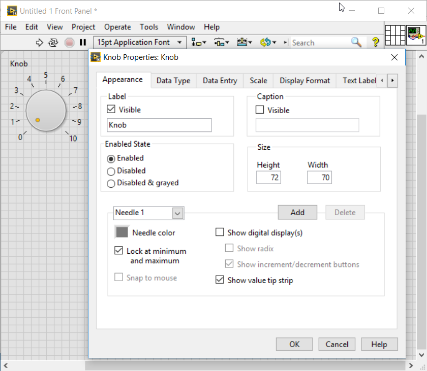

I have a full development licensed version of LabVIEW 2016 and whenever I right-click a control I only get an abbreviated properties window. I have checked the options and searched for an answer but cannot find a way to display all the properties on their appropriate tabs.
Any suggestions as to why or how to correct this anomaly?

I'm puzzled how you produced your picture.  I opened a new VI in LabVIEW 2016, dropped an I32 Knob from the Silver Palette (as that matches what you showed), right-clicked it, and chose "Properties".  This is what I saw:
I have no idea why you see something different ...
Bob Schor

The picture itself is produced using an application (Greenshot). Every control I have tried so far has only shown me what you've seen in my original picture.

One thing we often ask, particularly when something as "strange" as the pictures and reports you are sending us, is for the Poster to attach an actual VI for us to examine.  Attach the thing that doesn't work (your VI) rather than a picture of it -- we can then poke it, examine it, try to reproduce it, etc.
You mention that the Dial in your picture was dropped from a Palette.  Which Palette?  In my post that (I admit) showed a picture of a Control and its associated Property Sheet, I told you it was dropped from the Silver Control Palette (as I was "guessing" the Palette you used, based on the picture of your control).  I didn't say, but I used the Numerics sub-Palette (as that's where Knobs are found).
When did you install LabVIEW?  Has it always behaved this way?  Did you install it yourself?  I'm wondering if you have something seriously wrong here, but I can't tell because you didn't provide the information we need to better evaluate your problem.  Please attach a VI.
