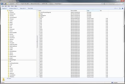

I see the full property page for that control when I opened your VI.  So I don't think it is a problem with your VI or your control.  I think the issue is with your LabVIEW install.
Message 11 of 13
(889 Views)
> There is no "32.txt" file in this folder or any other LabVIEW 2016 folde
If you are using 64bit LabVIEW, the path would be:
"C:\Program Files\National Instruments\LabVIEW 2016\resource\PropertyPages\32.txt"
If you are using 32bit LabVIEW, then that's the problem.
The PropertyPages should looks like this:Untitled.jpg
