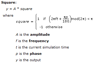

1) If you have a square waveform, the output is specified as:
20133i4121F78FA0D3C807
Thus, if you change the step size of the simulation loop, you alter the simulation times that are fed into the signal generator and that affects the waveform that you see if you do not have a small enough step size to characterize the waveform you generate.
