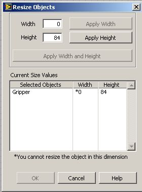

I know what I did wrong, the thing is that I w
ould expect an error or if I double click the terminal in the block diagram be able to move it back or resize it, because if you double click in the terminal then go to the front panel and select the resize menu, it says *You cannot resize the object in this dimension

Sorry, maybe I didn't explain myself (I'm not very good writing in english Smiley Tongue), my question wasn't about the movement of the control, my question was why after running it I'm unable to find the control and unable to resize it or reposition it. I had to replace the control and wire all the properties nodes again.

Hi Rodrigo,
you are unable to find the control because you moved it to far to the left...
LabVIEW has some problems when FP elements are moved to far (in a common sense). Those problems include being not able to find/move that element or results in an object with a width of 0.
Why would someone move an element to positions of >16000 in either direction?
