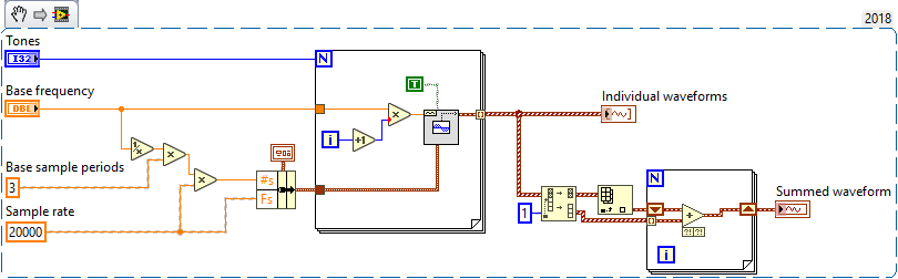

LabVIEW has For loops too. You just put your function inside the loop, and voila, it's called multiple times. It doesn't even have to be reentrant. For this use-case, only one thing can output to your sound card at a time, so you will have to pre-generate the sound you want, then play it.
If you have LV Full you can also use the Multitone VI's to generate multiple-tone frequencies all in one VI:
Message 11 of 13
(647 Views)

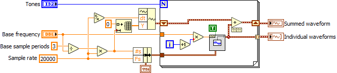

Or all in one loop, of course:
(even easier would be to place the addition into a i!=0 case. There are many alternatives)
