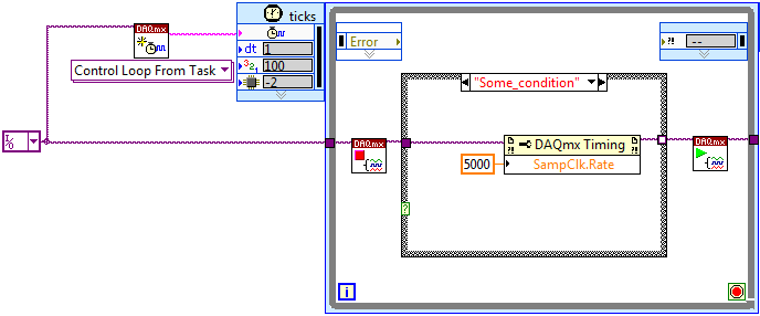

I was not clear enough: I was referring to the DAQmx create timing source VI. I was trying something like this:
But the error was thrown as soon as I stopped the task.
