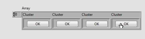

However, the mouseover image does not load if the the boolean is contained within an array of clusters (a single cluster with the boolean inside or an array of booleans works as expected):
The mouseover animation does work for a single array element in the above case (the one which was most recently clicked), but this behavior isn't desirable and it seems buggy if I were to leave this on my UI as it is.

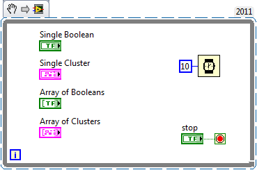

Hey Jason,
A reproducing VI would be any VI that contains an array of clusters with a system control boolean inside.  Here's an example:
Single Boolean, Single Cluster, and Array of Booleans all show the proper mouseover image.
Array of Clusters always shows the mouseover effect on the last element which was clicked, but does not show the mouseover effect on other array elements (actually, it seems to be inconsistent--every now and then it does show the mouseover effect on other array elements but it is not at all reliable).

Hi John,
Thank you for the clear example of this behavior. I was able to reproduce this issue in LabVIEW 2010, 2011 SP1, and 2012. I could not find a CAR that mentioned this unexpected behavior, so I went ahead and filed one myself. For your reference, the CAR number is 36785, and I believe I included everything you mentioned.
