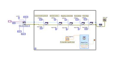

Dear GerdW,
Attached you can find my final VI and a YouTube video of controlling the VFD via other software as an example. I have changed the addresses as the manual is giving but still I havent used anywhere the manual data from page 128 - 136.. Should I add more addresses for those? The Addresses that I have add are from the attached video..
Again, thank you.

Hi Alexis,
In the VI shown in the image you only set some basic parameters (serial port, command source, local address) in this loop.
Why do you think you need to set those parameters in a loop, again and again?
There is no command to actually set some process parameters, like motor speed, speed ramp up/down settings, motor specific data (like current at default working point, default frequency, etc.), safety parameters (P5), !?
I guess you created some (hardware) safety features in your testbench to prevent disaster in case your LabVIEW VI doesn't work as intended?

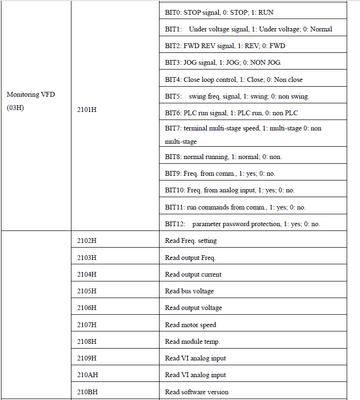

Dear GerdW,
I have also the following data, but I am not sure how to write them in the VI. For example for Commands of VFD. I will put address 06 and then input data which part? I am not sure how to combine the parameters address and the function description.
Then I need also to add in the same way for Monitoring the VFD (read frequency, motor speed, etc).

Hi Alexis,
The shown table says: parameter address/register 2000h, values from 01H to 09H. That "command to VFD (06H)" denotes the Modbus command type.
The same applies to the other table: Modbus command type "03H" to read several registers/addresses…

Hey GerdW,
Thank you for the link. I find great difficulty to understand it, mostly with the Commands to VFD and specially for the Monitoring VFD since there are only addresses and not values. In your previous comment you mentioned that I havent input any data such as motor speed, current or default frequency.
Not sure if I need to use the Commands to VFD or Monitoring VFD or both since the motor speed is control from the frequency..

Hi Alexis,
Those "monitoring VFD" values are entities you want to read from the VFD, so you need to send a read request with the register address to be read. The response of the VFD contains the register address and its value - as described in your manual!

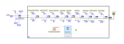

Hello GerdW,
I have added some parameters as you suggest it. The <<Monitor VFD>> is 03H, and I have added the most important parameters as you can see in the image. But initially, I have add also the <<Terminal Protocol>> which was from P3.00. Will it make a troubleshoot with the terminal protocol because is also 3?
Is this schematic more correct than the previous?
