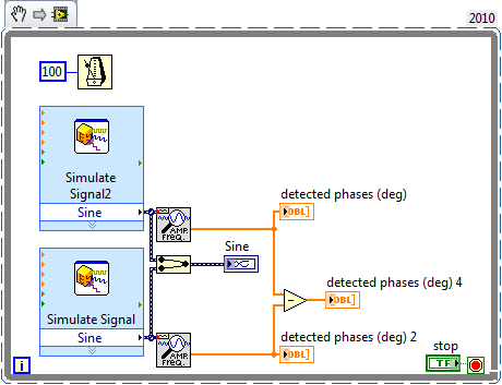

Hi Luis
Let me explain myself a little better. I am using a usb6009 conected to a DC motor. I am actualy generating a sine waveform using the sine wave generator from Labview an want to see the output speed from the DC (Tach-output). The goal of my experiment  is to get, in the same chart a display of my sine input and my speed output signals to determine the phase shift between the two of them and ultimatly construct a bode diagram showing magnitud and phase. Since the usb6009 input/outpit is only 0-5V, I am using a fix ofset for the input sine wave of 2.5V. Now, I am already seen the two signals in the same grapgh but the input at 2.5 and the output lifted above this value. I need two of them at the same value on the Y axis to be able to measure the phase shift. I am new in using labview so I have experiencing a lot of dificulties on this matter

I am just not getting you are plotting the output singnal and the DC motor voltage?? I am not getting how are you measuring the speed of the DC motor. Do you have any kind of traducer that sends you a different amplitude voltage signal than your output signal??
Another thing I would like to let you know is that we have a couple of VIs that hepls with the phase measurement, this are called Multiple Tone Information.VI and Tone MeasurementsVI.
You might be able to use them!!
Now, here is a link with a small LV course: http://zone.ni.com/devzone/cda/tut/p/id/5247 Take a look at it. you might be able to use it.
I also added a VI which calculates the Phase between two different signals with two differnet Amplitudes.
I hope this helps a little bit, and I will keep an eye on this forum.
PS If you need any other LV version of the VI, let me know!

Thank You Luis
I am sorry for taking so long to reply. I think I omitted a detail and it is that the version of LabView I am using is 8.0 so I have not been able to open the solution you sent me. Attached is the VI that I built so far. Just need to be able to display the phase and amplitud of the output from the DAQ, just befor the merge signal icon
