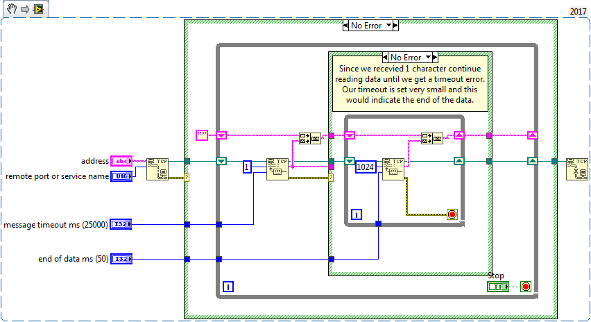

Here is an example of reading blocks of data with no termination character. The message is determined to have been read completely when the short timeout occurs. THis would indicate a space between different sets of data.
As for displaying the data I would have a separate loop handle the UI stuff. Use a queue to post the data read from the connection to the UI loop. Have the UI loop update the display once a second or whatever interval you want.

Thanks Mark_Yedinak
there looks to be some real meat to your comments that will take me a bit of testing to even understand. Especially intriguing, is to only worry about the error on the first read but not the latter ones.
I will revisit that. Maybe over the modifications I am in a different place to understand the responses of not only the Labview code, but the way the unit under test communicates.

Understand that my example is very basic. Normally when I do this I do check for errors on the inner read. I only ignore timeout errors. Other errors such as the connection has been closed or similar types of things are handled gracefully. Though in the case above the initial read will catch those as well.
