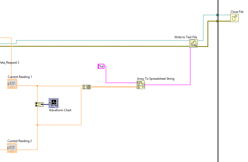

This is a huge help, thank you. I've created the steps outlined in a separate VI to make sure I have it understood for outputting a number in a while loop. I can get that to function as you explained.
My issue arises when I try and combine my current readings into an array to spreadsheet. I'm outputting zero's in my output .txt file instead of the values that are being read and displayed on my waveform chart. Below is a screenshot of my messy wire diagram. What is the issue here?
Again, thank you for your help, it is much appreciated.
