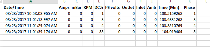

OK here's the TDMS data imported into Excel.

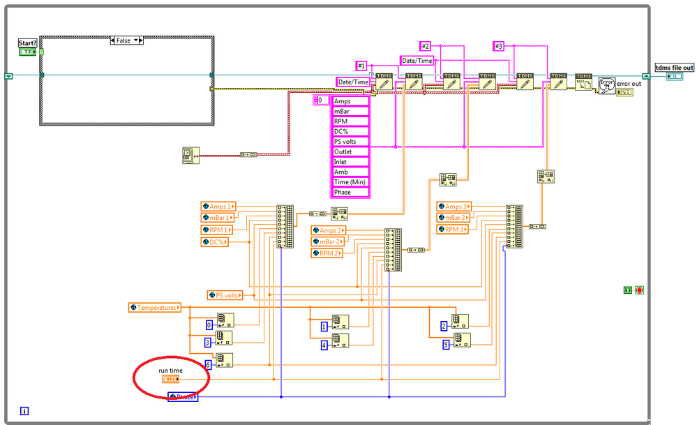

As you can see the Time column is the culprit. This is the subvi code,apologies for the mess it's seen a few changes in the last few days. The control "run time" in the bottom left corner is where the time data is brought into the subvi. I like Altenbach's idea of turning it into an alphanumeric string but since I'm using arrays it would take some redoing of the code and I thought maybe there was an easier way.block.PNG

This is just a blurry picture. How about changing the format of the excel cell instead?
(You know that "index array" is resizeable and that you don't need to wire the indices if getting all elements in order, right? What's the purpose of the while loop?)

All you need to do is to set the numeric format for that Excel column as needed…
