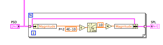

Since you did not save the input arrays with typical default data, we cannot run your VI. When using comparisons in while loops for stopping the loops, using Greater Than or Equal? or Less Than or Equal, depending on the logic, is much safer than just Equal? For example running the VI you posted (with empty input arrays) results in -1 at the array size -1 input to the Equal? comparisons in both loops. So neither loop will ever stop. Since you are only comparing to the size of the arrays, use a for loop with autoindexing.
Using Insert Into Array is almost always not the best way to do whatever you are trying to do and using Build Array in a loop results in multiple memory re-allocations as the array grows. Initialize the array to the final size (or something larger than the largest expected size if the exact size is not known) and use Replace Array Subset inside the loop.
(10^(-5)*2)^2 =  4E-10. Rather than recalulate this velu on every iteration of the inner loop, place a constant on the blockd diagram. Use a descriptive label or free label to describe how it is derived if that is significant. If it is necessary to calculate something which will never change while the program is running, move the calculation outside all loops.
I suspect that the code in the image below does everything you attempt to do in your VI.
Lynn

Thank you for elaborate explaination. It is perfectly working.
I am new to labview and I am implementing as I do in programming language (PL). Labview is different from what I do in PL. I will improve on memory efficiency areas.
