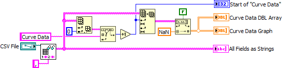

Maybe you would want to search the first column for "Curve Data" (without leading spaces, there are some similar fields with leading spaces), then read the following rows as DBL.
Here's one simple possibility. See if this can give you some ideas.
Message 14 of 19
