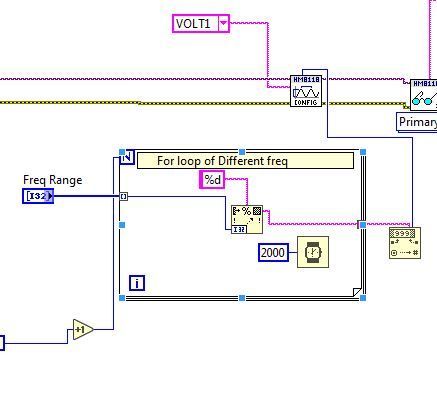

I do it like this and it's work Now
Message 9 of 13
(4,445 Views)
Then consider to Accept a Solution.
Still a few things on my mind:
+ Every wire (but 2 or 3) has unneeded bends. Why not straighten those wires?
+ Why not work from left to right (wire going to the config driver VI goes from right to left)?
+ Why convert a number to string, and then convert it back to number again?
+ Why not use the diagram label for commenting the For Loop (more convenient then a free label).
+ That for loop only returns the last Freq Range to the driver. Why not simply take the last value from the array (Delete From Array does that), and remove the for loop?
+ If you want to send each value to the hardware, the driver VI's need to be in the loop.
Of course we can't see the hole picture... Nor can we show you as we don't have the VI (just an image).
