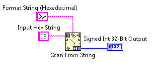

You can do it with the Scan from String function:
This would output "27".

Thanks that worked.
