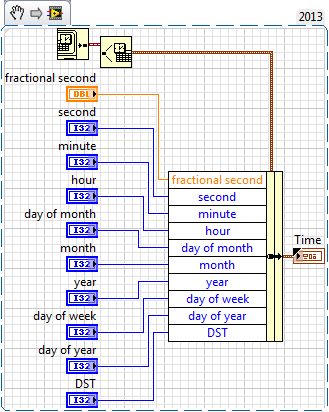

As long as you are retrieving the components of a date time record- just bundle them:

Hello Jeff·Þ·Bohrer,
My problem is retrieving the components of the date in the fpga target.
You can show the attached file below to understand my problem
Thank you
