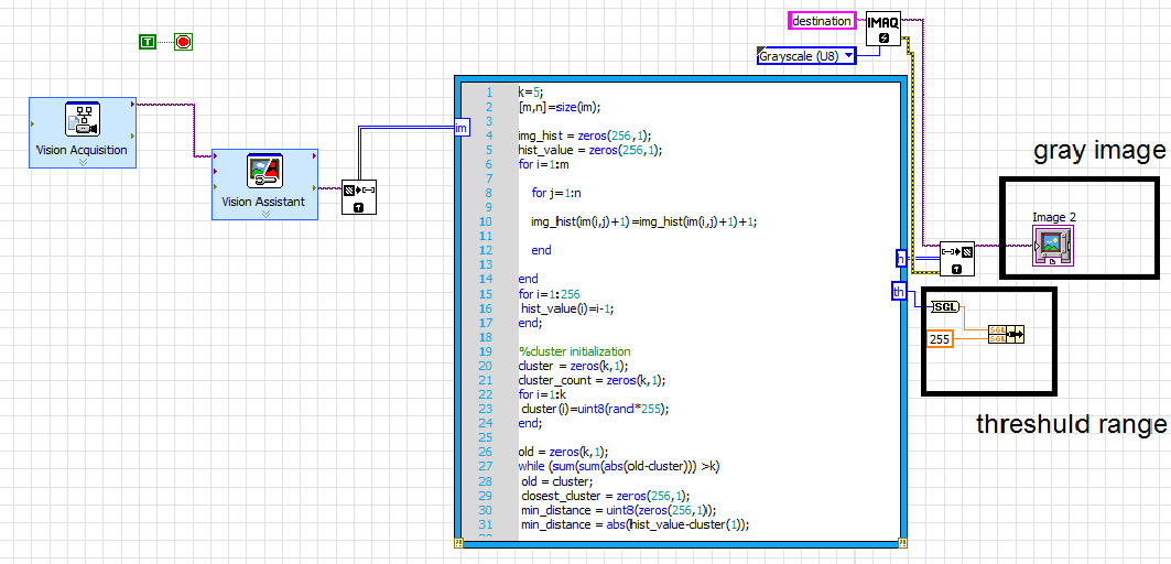

I have this vi that do some processing on the aquired image from webcam
every time I put threshold vi  on the result of math script ,every display image vi all ways become black
if I remove the threshold vi the vi work well
Please I am tired
the threshold should be between th and 255
best regards

Hi Saliim,
I would suggest making sure that you create a new IMAQ image buffer for storing the thresholded image. This will prevent the thresholded image from overwriting the original image in memory. I hope this helps!

thank dear
as you said extacllay ::::solved
