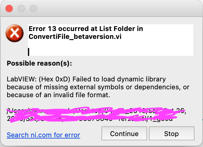

When I start the algorithm, I select the file to convert and it gives me this error:
How can I solve this?
You try to use Waveform files and save them into spreadsheet (TXT) files. Are those files really waveform files?
Can you attach a file where you get that error message?
To get rid of the error dialog you only need to handle the error programmatically!

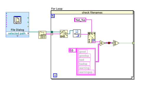

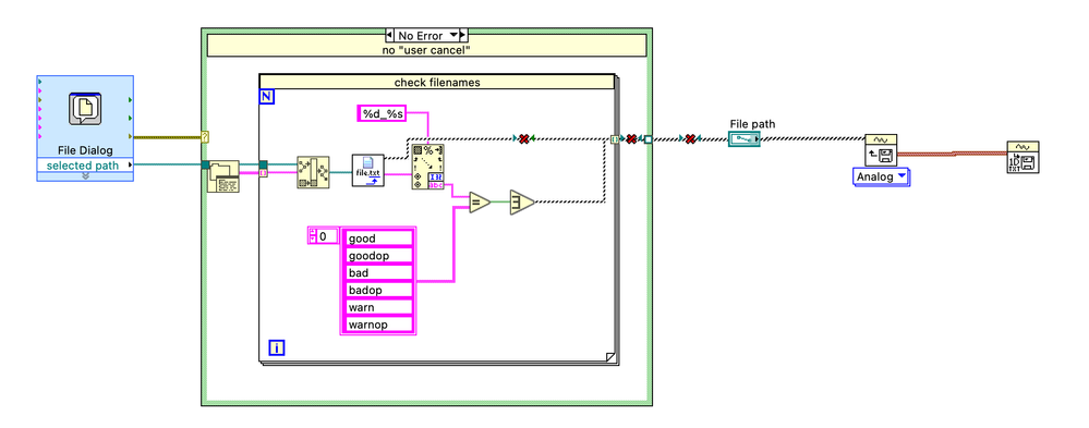

Hi Jack,
a simple approach:
Message 16 of 21
(1,278 Views)

Hi Jack,
@JackRen3 wrote:
I was able to replicate most of what you showed me, but I couldn't find the outer structure "Kein Fehler".
Did you ever use a case structure before? Do you know you can connect an error wire to its selector input as I did in my snippet? Did you implement some error handling before at all? ("Kein Fehler" is German for "no error"…)
@JackRen3 wrote:
Also I couldn't find the very external green element on the right of your sketch.
Did you ever create any frontpanel elements? Do you know their representation in the block diagram is called "terminal"? The loop creates a path array on its loop border, so the indicator to the right is an array of path…

Hi Jack,
@JackRen3 wrote:
Thanks GerdW, you're being extremely helpful, I'm struggling with this process since September.
More than 2 months should be a lot of time to take the training resources offered in the header of this LabVIEW board!
@JackRen3 wrote:
After creating the green element on the right, I should add the 2 blocks for the conversion from analog to txt? Right?
I used a "conditional output tunnel" at the FOR loop! Use the context menu of the tunnel (aka right-click menu) to set it to "conditional": each filename is checked in the loop and added to the output when the condition is met…
The loop gives you an array of valid paths: you need to use a loop to autoindex each element in this array and do the conversion. (You might also do the conversion inside my FOR loop, based on the condition evaluated in the loop! I just made that snippet to show a solution to your current problem: programming also means to be able to split a big problem into smaller problems and solve them one by one…)
