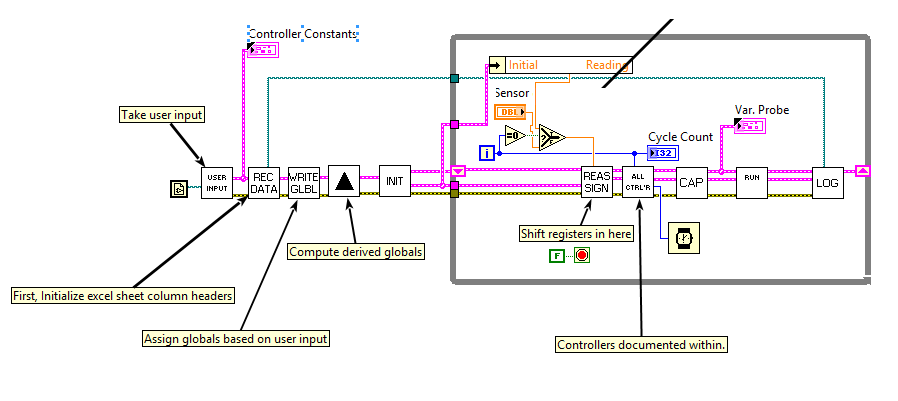

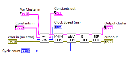

As am I, if you couldn't tell 🙂 Here are two screenshots that give a little more detail. The second image is the inside of "ALL CTRL'R"Capture.PNG

It looks like a state machine would do nicely.  One loop with everything inside.
Generally wiring False to the stop terminal of a while loop is not a good idea. Forcing the program to stop by hitting the Abort button can leave the hardware in an unknown state, files open, and so on. Either calculate the end of the operation or include a Stop button or an Application Close event so that you can shut everything down in an orderly manner.

I actually had an event-driven stop button built in, but it was causing problems as it would hang the program from moving on. The Timeout couldn't be too low, or you'd never register an event, and it couldn't be -1 as it would never move to the next iteration. If you've got advice for how to handle that, I'd love to hear it!
Message 9 of 20
(5,162 Views)
ijustlovemath wrote:The Timeout couldn't be too low, or you'd never register an event,
Where did you hear that?
Events will always register.  You can make your timeout 0 on an event structure.  Any code inside the timeout case would immediately execute assuming that no other event has already happened.
