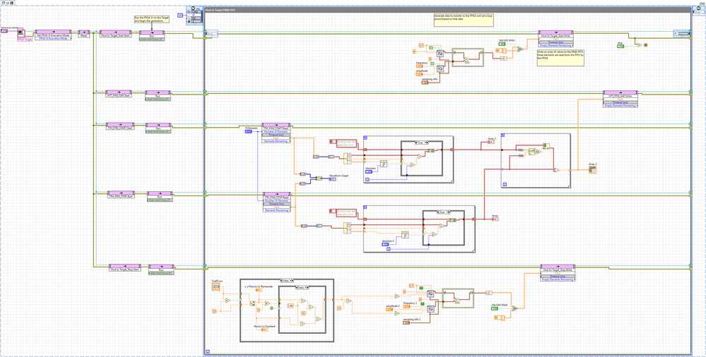

Hi, I'm new in LabView and I have a problem with my project, I'm emulating a FFM generating two sines, this part works amazing because I have the gap that I want, the problem is with the acquisition, I have to obtain the gap of this sines and convert it into a voltage, I tried to read the gap with a "zero crossing VI" that I found in the forum, the problem is that I don't know how to convert this gap into a linear voltage.
