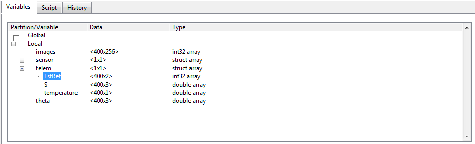

I'm in the process of taking a fairly complicated MATLAB program and ideally embedded it within a Mathscript or if we have to, a MATLAB mode within LabVIEW.
Getting the code itself embedded has actually been a relatively straightforward task, but where I am having difficulties is how to get the appropriate data into the script node. This is a very easy task with simple data types (i.e. numerics, arrays etc), but the input for this node is quite complex (attached sample pic below) and I'm really not sure how is best to get this into the node. One possibility is to read it in within the node from a .Mat file, but then as we acquire the data in LabVIEW there would still be the task of converting from say a LabVIEW cluster to a .mat format.

If is were me, I would unbundle the cluster and send it into the MATLAB script node as more basic types and then reassemble it inside.
Data types get tricky with that thing.
