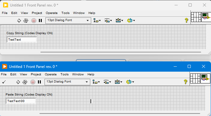

these days I discovered to my cost that by performing a simple copy paste operation between two labview applications (2023.3.6f6) the string we are going to paste will contain the copied text with a null character (code display \00) hanging at the end.
This behavior is also achieved simply by using two different instances of the development environment.

image:
LV_Copy%26Paste_IssueLV_Copy%26Paste_Issue

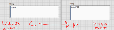

I can confirm things are off:
EDIT: This was actually a copy from LV23 64-bit to LV24Q1 32-bit.
Not sure if it's off in the same way as you described.
It seems to be in the pasting, not the copying.
Pasting the string in LV20 give the expected result.
