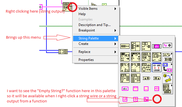

Maybe I am not being clear with what I'm actually looking to do. Maybe the following image will help.
I am not really looking for alternate solutions other than what I have asked. I am aware of all the various ways to navigate to the function I am looking for. I only want to know how to move or copy a built-in function from one palette to another.

There might be a workaround to give you the functionality you are seeking
I will try to explain
Lets assume the add primitive.\
First wrap the add primitive with a vi and save it to a 'Snippets' subfolder of your User.lib folder
THen make sure each VI has its icon edited to hold a pic representation of the node you want to use so that it can be seen on the pallete.
In our case we copy the add primitive from the BD then paste it into paint. (You can copy paste to paint and then recopy into clipboard to get the bitmap image of the add primitive.) Place this into the VI Icon.
AFter the VI is ready you can insert it into the pallete
Go to  Tools Advanced Edit Pallete sets
Go to each position you want to populate with your wrapped function, insert it and then select 'use VI Contents'
Im pretty sure you will get what you want out of this, but it is a bit tedious to set up.

This is exactly what I was looking for, thank you! I did not know how to add VI contents to the palettes.
