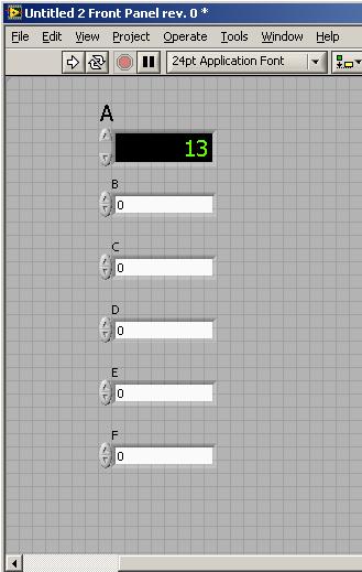

Imagine I have some controls on the panel in such a way (see figure).
I would like to be able to copy the entire format (colors, font sizes, alignment, etc...) from control A to the other controls.
Is the a way to do it witha single command either programmatically and in edit mode ?
Thanks you.

Ok, I understand that if I create a strict typedef, and then many controls o that type, each change to the typedef itself will be reflected on all the controls.
But imagine for some reasons I do not want to create a typedef for each of them, I just would like them to look them same.
I was thinking to something like the Microsoft Word feature that you select some text, then you hit the button "Copy format", then you select some other text, and the two selections look the same (fonts, colors, size, ecc).

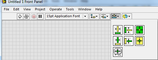

You can modify the default font settings in LV. To do this, you have to open the LV Options => Environment.
This affects the fonts for future controls you create. It does not affect size settings like width or height.
If you want to modify this for several controls at once, create them, select them and then use the "Resize Objects" button in the icon bar:
hope this helps,
