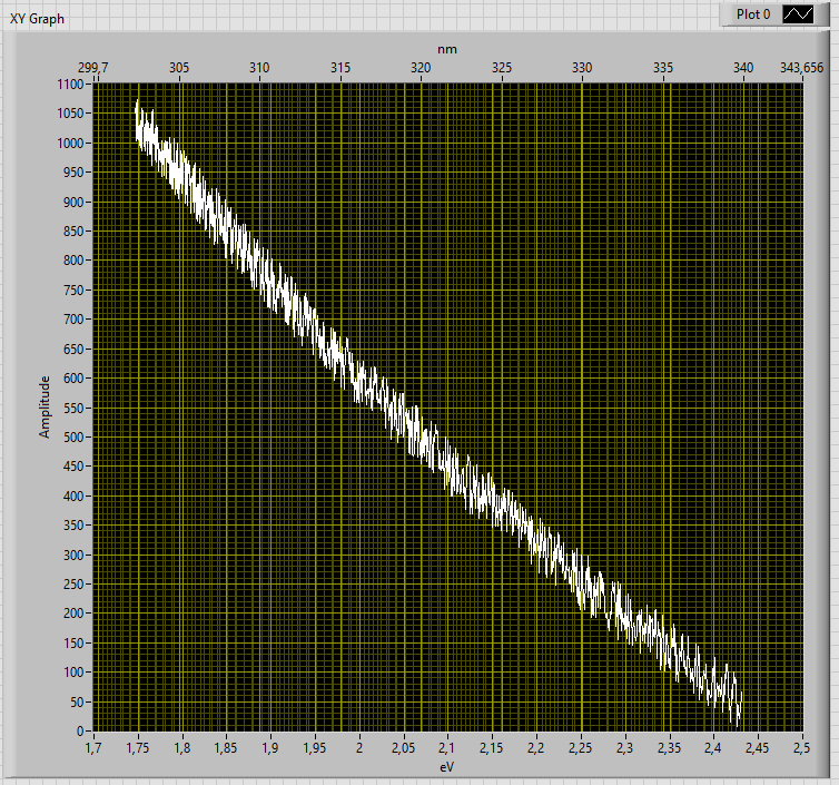

I have some wavelength data [which comes in units of nanometres] and want to plot it in units of electronvolts.
Specifically, I want two x-axes on my XY-Graph, the bottom one in units of eV (increasing from left to right) and the top one in units of nm (therefor decreasing from left to right).

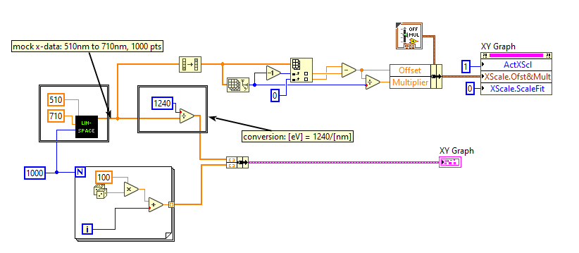

I can not for the life of me get the top axes to show the correct scaling. Whatever I make the bottom axis is displayed correctly, but then I have to calculate what exactly the top axis scale looks like. I do this and set it with the Offset and Multiplier property, but it doesn't work.
Please see the attached picture and vi.
The picture shows some mock data with a correct bottom x-axis (in eV) but wrong top x-axis (in nm; should be about 730 to 520 from left to right).
wrong top axes scalingwrong top axes scaling

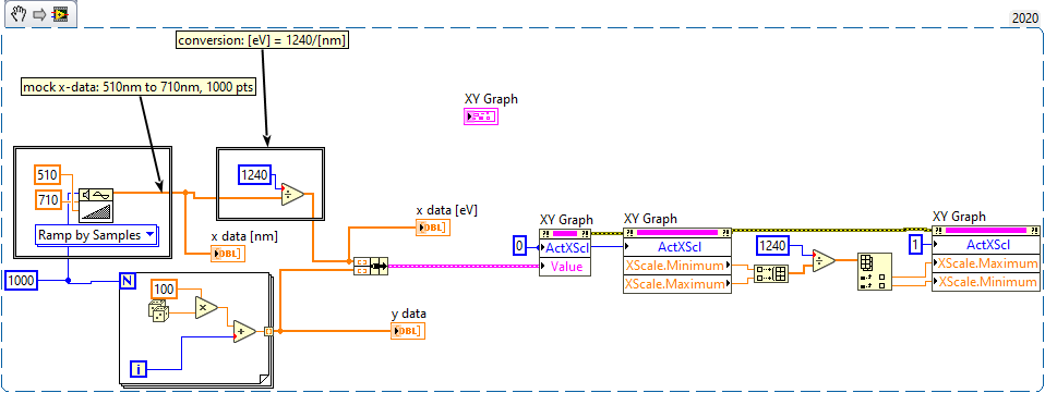

sorry i can not edit my above post. here's a block diagram snippet of the attached vi...image.png

On your problem: have you tried to set the XAxis.Range property? It allows to set the increment between the min/max of the range: you also need to change it according to your scaling factor!
(For a quick improvement it might help to hide the grid lines for that 2nd X axis…)
Btw. this LinSpace VI can be replaced a simple Ramp function call. (It comes with LabVIEW and is [more] bug-free than your VI: when I request N points "including the endpoint" then I don't want to get N+1 points…)

Thank you for your feedback, @GerdW and @BertMcMahan, I have incorporated your suggestions. Ultimately what helped was first plotting the data on the bottom x-axis, then grabbing the scale bounds from that, convert these bounds back to nm, and finally apply them to the top axes (in reverse order, i.e. eV_min becomes nm_max etc.)
