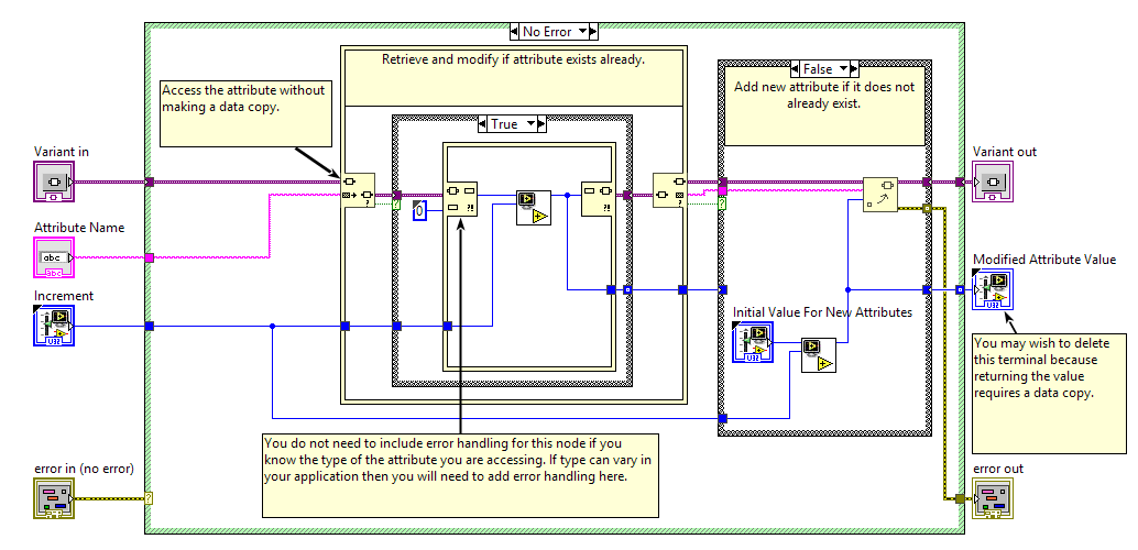

The example that ships with LabVIEW "Modify or Add Variant Attribute.vi" covers a manipulation case where you need to read the current value of the attribute, manipulate it and then replace it with the manipulated one. Here is a screenshot of this bit:

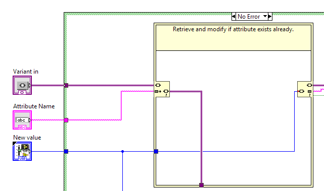

The example does not cover cases where you do not have a need for the previous value, but just want to replace it. You can then either replace it with an attribute of the same data type, or with a different data type...
To illustrate the first of these it might look like this:
There are two questions that come to mind here:
1) Is it OK to skip the whole variant to data IPE bit as I've done here...that seems locial as I do not need the previous value anyway.
2) I have skipped the case to handle whether the attribute was found or not (the IPE help states that if the attribute is not found the whole oepration is ignored anyway...so why care about the if-case unless I have some additional handling to take care of then?
3) Why does the code break?
The broken state is caused by the fact that the output of the "Get attribute" part of the IPE in this case has not been wired to anything. The IPE has the rather strange requirement that it requires you to wire some outputs...not just inputs. OK.

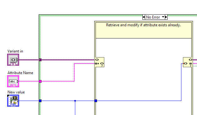

But hey, it does not seemingly matter *what* we wire it to. We can for example get back to running code just by wiring it to the side of the structure, like this:
Now everything seems to work fine, *and* the performance gain has been maintained.

The in-place element is designed for read-modify-write operations as the idea of it is to be a memory efficient way of replacing/modifying some data in a memory space that already exists.
I do agree with you though - I don't think it should cause a broken run arrow if you don't wire out the original value.
If you are just updating a value and don't care for the previous value, just re-set it using the primitive as it does on the right-hand side of the diagram?

If you are thinking about the right-most bit of the first picture where the example uses the non-IPE set attribute primitive to create a new attribute (?) then that would not produce the performance gain introduced with the IPE (at least my tests indicate that I get an improvement). I can use the IPE as in the third picture (with the output wired to the side of the structure to avoid the broken arrow) for that, that works fine.
