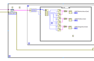

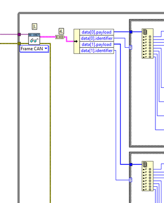

in my VI (attached) I receive two CAN Frames every 100 ms (ID 0x44C and 0x451 / 1100 and 1105). My program is working but there has to be a more elegant way to access all the payloads with a single CASE structure. This is how it looks:
Any advice please?

Can you attach some typical data coming out of point "3." (temporarily create an indicator there, run the VI until it has data. Stop the VI and, disconnect the indicator and turn it into a diagram constant, for example)

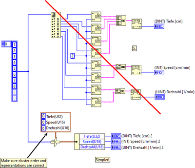

  • Array to cluster is just plain silly and a detour. Not sure why you would create a 9 element cluster if there are only two array elements.
  • Autoindex on a two iteration FOR loop and process the two array elements.
  • What is the probability that both IDs are the same. Whatever writes to the terminal or local variable of same wins.
  • I doubt you need any local variables or coercion dots.
  • Your representations seem all wrong. "Speed" and "drehzahl" are seemingly 16 bits and "tiefe" 32 bits. How big are the blue U8 arrays? You can probably just typecast it to the right final outputs.

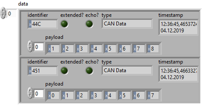

Sample data from "3." (this is just simulated payload, the final values will be different)
Edit: I changed my code to this and it seems to be working
Edit 2:
According to my representations: I was given the information that I would receive two CAN frames, and that the payload from ID 1100 consisted of "DINT Bytes 0 to 3", "INT Bytes 4+5" and so on... I do not object to this maybe being not reasonable, but I do think I did this to specification (or at least I hope I did 🙂
Edit 3: I thought about it and you are right, I have no idea why 4 Bytes should be represented as a I64, makes no sense. I'm going to get some information about this, maybe I have been misinformed...

As I said, all you need is a typecast and correct representations. Same result, no pink, infinitely more efficient!
(Please check if these could be signed integers and modify as needed).
