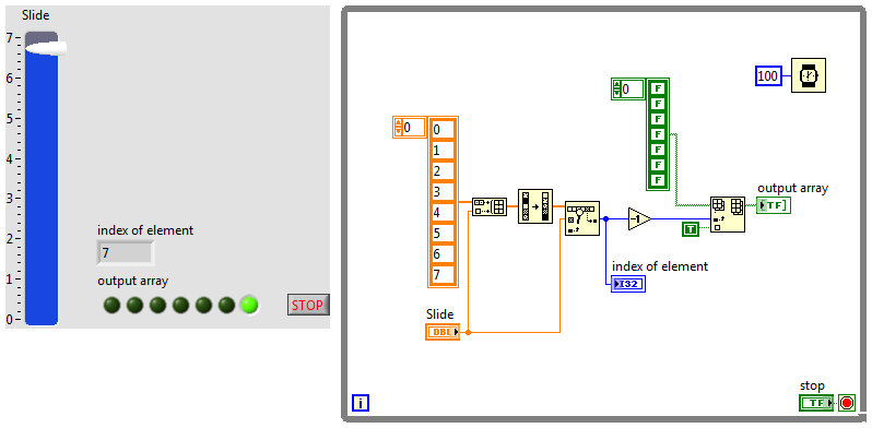

I recommend to use arrays instead of gigantic code with many duplications. Here's one possibility.
We keep the count of gear changes in a shift register and increment whenever the gear is different to the previous value using a feedback node. Modify as needed.
(4,013 Views)

i meant to,lunch time, wife called...
my suggestion, shift reg,comparison,add, select...

Thanks guys, that's absolutely fantastic! I'm using feedback nodes and shift registers in other parts of my project, and played around with them in this VI after posting up but I couldn't get it to work how I wanted. Thanks for suggesting that I use an array - it really has tidied up the code.
I'll have a good look through the solution, and see what I can learn from it!
