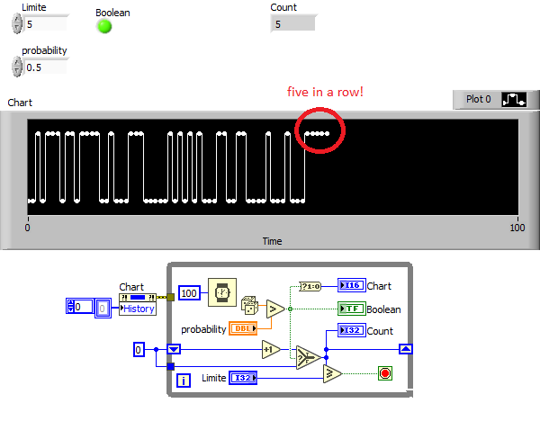

@giu95se wrote:
I am attaching what I have tried to do in vain.
WIth each iteration the boolean needs to be true with a certain random probability. Use the dice.
The following is similar to the second suggestion above. For illustration I also added a chart. Make sure to study it in every detail.
